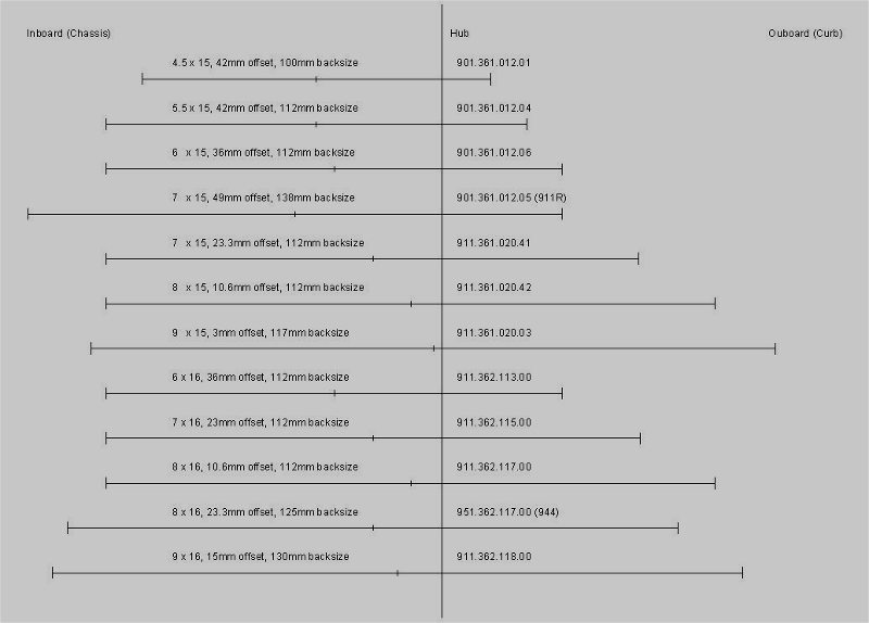

    I need to know the offset value of my 5,5 x 15 Fuchs wheels on my 911S SWB? See pic
    Can anyone give me some advise about that or where to look for?

    Try this. I can't remember where I picked it up or vouch for it being completely accurate.

    You do understand that the offset for 5.5s won't help when ordering 6s?
    The 6X15 Fuchs are about 36mm. You can subtract about 10mm and still clear the fenders.
    BTW, Porsche lug pattern 6X15 Miniites should be designed for your fitment.
    The dealer should know what fits your car.

    Hi harvey,
    That is what I wanted to know.
