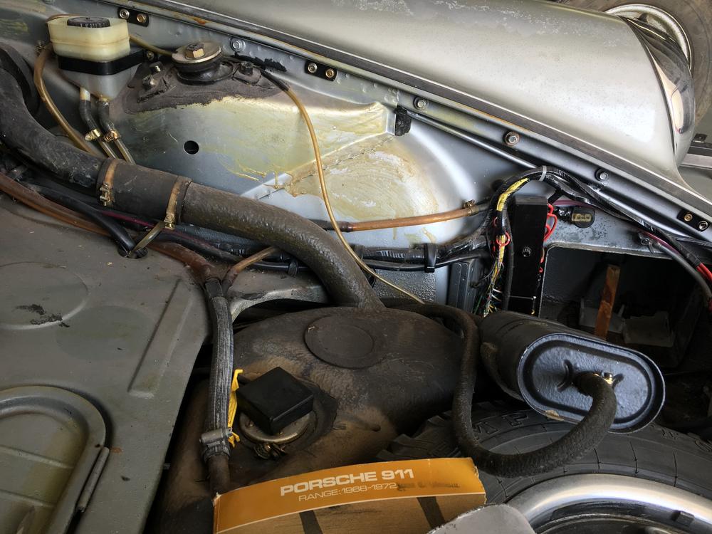

    I'm restoring a 69E. I'm guessing it's a late 69 as I've run into what appears to be a car with some 69 and some 70 parts. I have a driver side headlight bucket that has the bosses for the vapor tank strap, and a trunk pan that can accept the mount for the carbon filter. What I don't have is the plumbing through the tub. The black fender well is the 69E the silver one with the vapor tank and carbon filter is a 70 or 71T. Lines 51 and 56 seem to go forward but to where? The atmosphere? Help me get a handle on this please.

    69 was one year only fuel vapor ventilation system
    http://www.early911sregistry.org/for...l=1#post550811

    Thanks for pointing me to that thread. I'm still not sure where the line with the red circle goes.
    It looks like I'll have a nice vapor tank and charcoal filter for sale.

    On a 69, line 56 doesn't exist.
    51 goes overboard as described in the thread above. 54 goes to the fuel tank.
    I imagine 56 is there for 70-71 cars and goes to the charcoal canister and those years don't have a 51
