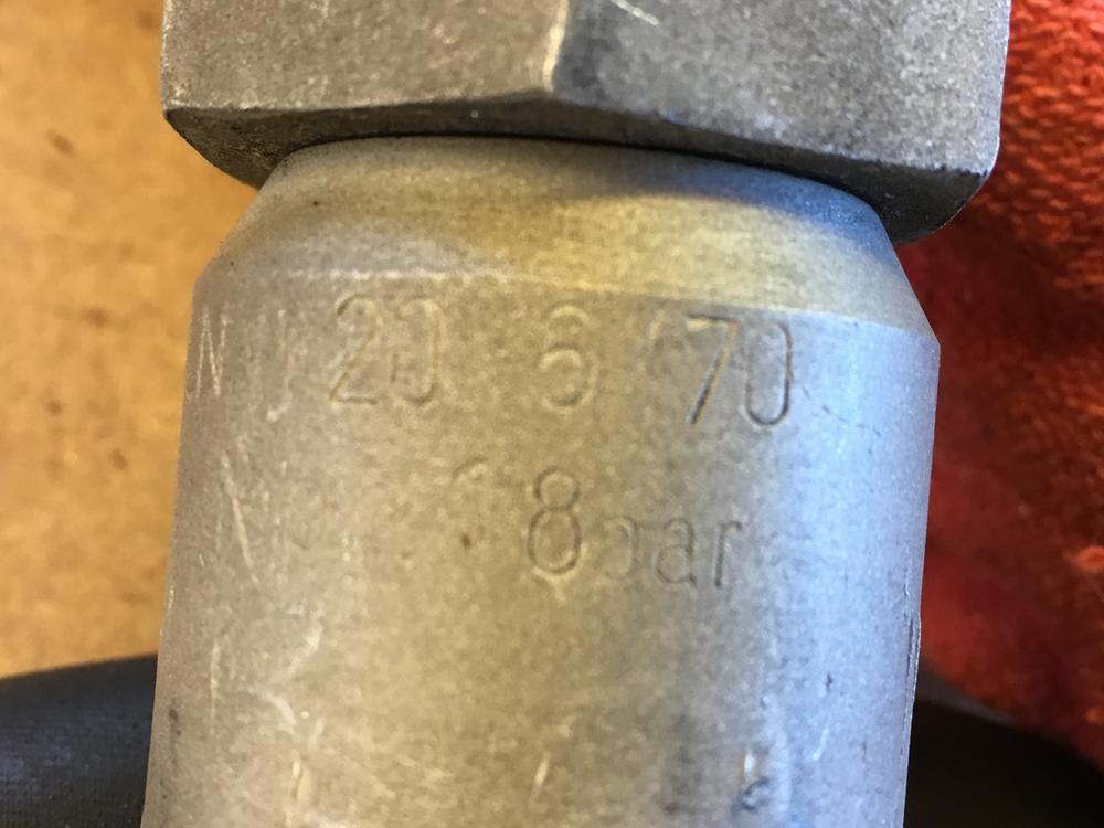

    The long OLN hose is dated 20-10-69. The short OLN one dated 20-6-70. I have both ends for the shorter line.
    Can the be rebuilt? And who does it if they can.

    Yes they can be rebuilt.
    Numerous threads on the subject
    Search Brad Davis Cohline. Cloth
    1969 S Coupe #761
    Early S Registry #1624
    You can buy the bulk line from him & do it yourself or have him do it for you:

    How does the rebuild save the dated sleeves? Aren't they crimped on?

    No, these lines are not crimped.

    Chris,
    Call Brad, he has the tools, hose, and replacement parts. The fittings are made by TechnoChemie, TCH, some are all aluminum, and some are a mix of aluminum and steel. You see them mostly on 69 to 72 911, and 914/6 cars, along with most racing oil systems. The aluminum is very delicate, I've seen some damaged beyond repair because the person used a pipe wrench...inside the collar are a set of fine and corse threads, the fine thread is for the tapered tube, and the corse thread is for the outside of the rubber hose.
    Ernie W
    member of Early 911S Registry
    Thanks Guys!
    Chris, happy to help any way I can. Give me a call or email anytime. The M30 x 1.5 size TCH lines are the easiest to rebuild. I am sure you can tackle it, or I am happy to do it.
