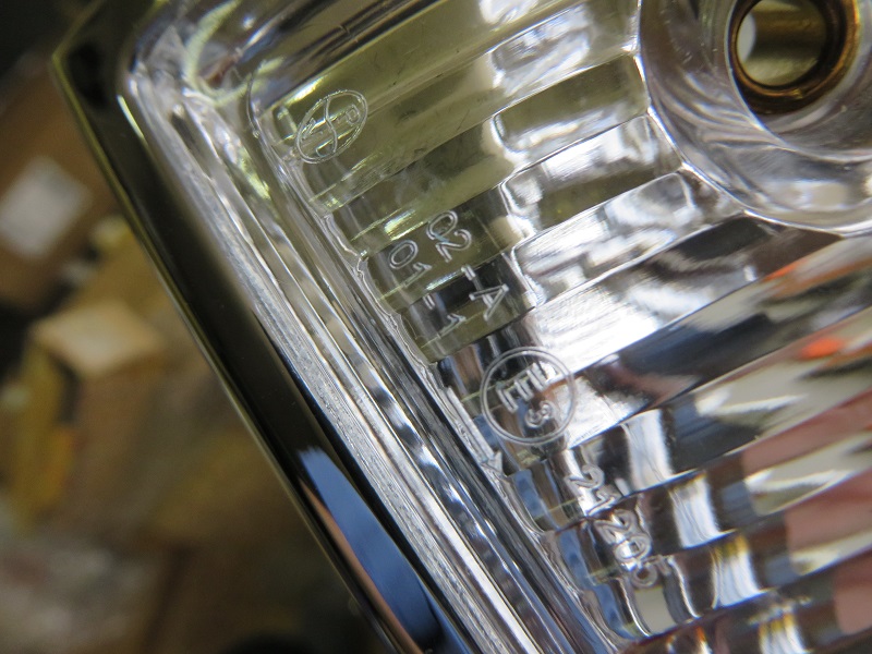

    Of course, we have to put up with the extra modern lens markings as well which really defeats the purpose of having proper vintage marks (IMHO).

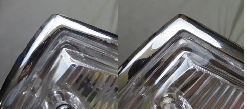

    The housings are probably my least favorite part of the Porsche Classic units. The difference is subtle but it's enough that it bothers me. Quite simply, they look almost too good, too uniform, too well made, too modern. They're VERY shiny (which I like) but the trim looks to be slightly squared or perhaps less rounded, less "soft". It's so consistent that it stands out. Am I making sense? Don't get me wrong, it looks beautiful. It just doesn't look 100% original.
    This is very hard to photograph so bear with me. NOS on the left and Porsche Classic on the right:
    More visible here. The pointy tip is way too pointy:

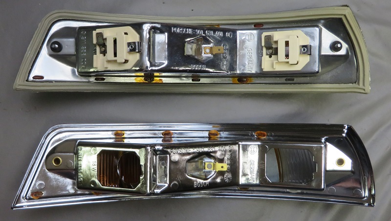

    Yes, Back Sides Matter.
    NOS up top and Porsche Classic on the bottom:
    If you look closely, you can see one of the issues right away. For some reason, the entire back is covered with circles that are part of the casting. They're everywhere. Like these:

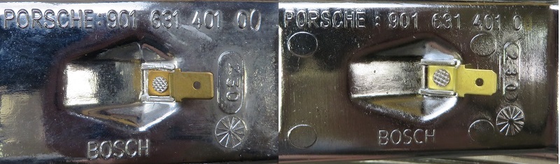

    Why are they there? I can't see any reason for them. Of course, it quickly becomes obvious that Porsche didn't try all that hard to get the back sides right (NOS on the left and Porsche Classic on the right):

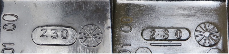

    Lots of little differences. Can you spot the biggest one? How about in the photo below (NOS on the left and Porsche Classic on the right):
    Yes, the oval is wrong, the "230" font is different, but look at the final digit of the part number. It appears to be screen-printed.

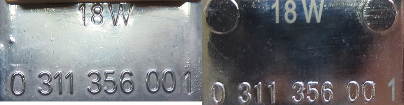

    More screen printing on the 18W and the final digit of the Bosch part number:
    Just very weird.
