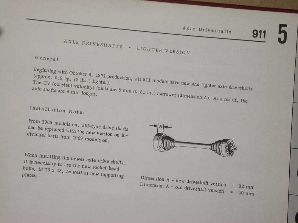

    That list is not very accurate. There was a change in CV joints and axles in the '72 model year, prior to the 923 (not 932).
    Also be aware that the bolt sizes changed a few times between M8 and M10.

    How can 69-71 CV have same part # as 72-75.5 when outer race is different width?

    The CV P/N for the 1972-1975.5 is listed correctly. I have not found a listing for the '69-71 CV .
