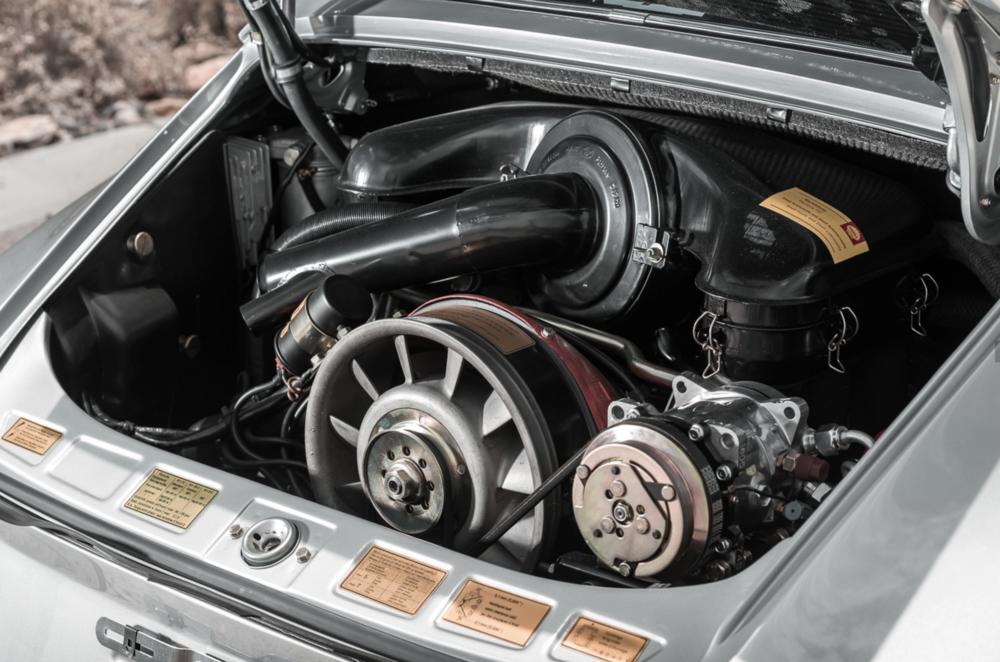

    I've noticed some 911S's have snorkel pointing to the right side of the engine,
    and others pointing towards the left side. Is this solely because of the A/C pump option?
    I've seen a few 911S's (without A/C) with their snorkel pointing to the right.
    *Mine points to the RIGHT but has no A/C.
    Both cars in photos are 1971 S's
    Yes, because of the AC compessor.

    the green car has a green fan shroud -- looks to be a 911E not a S
