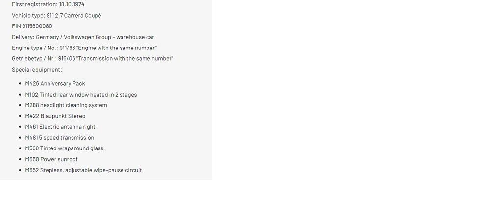

    As we can see, 568 is mentioned but m102 is not mentioned despite containing it. Italy was mandatory M102 in 1972?
    https://www.elferspot.com/en/car/por...-1972-2027970/

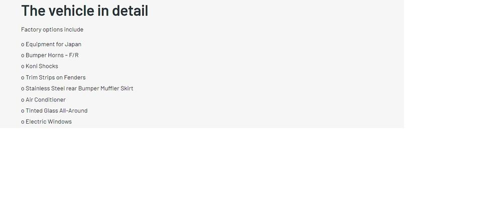

    m568 Japan
    https://www.elferspot.com/en/car/por...-1972-2377332/
    M102 is not named but it is included in the car.
