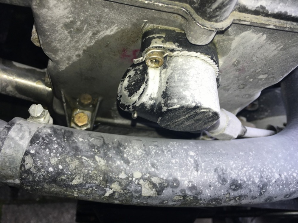

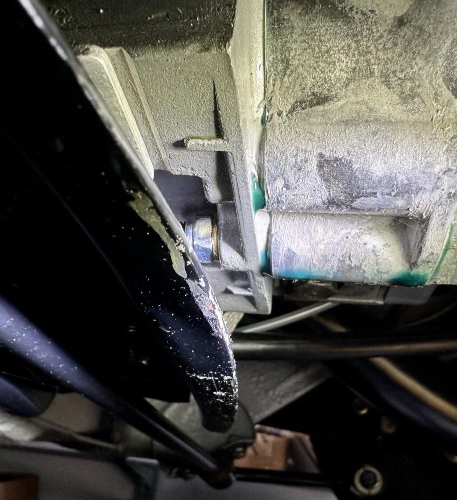

    I now have 99.9% of the kinks out of my 71S which was a nuts and bolts restoration and full engine and gearbox build. However, I have what seems to be at least a couple of oil leaks. The engine and gearbox shop have offered to take the car and fix without cost. Before I do that, and in the interest of learning, I thought I would see if I could fix first. There seems to be at least two engine leaks and also a gearbox link - blue color. Attached below are some photos. Seems like I would need to remove the heat exchangers yo get a decent look. Any advice ?

    It appears to be Swepco oil in the transaxle , in my experience this oil essentially dissolves Yamabond type sealants , I'm not a fan . The one leak at the bottom of the trans - engine may be coming from the oil thermostat , oil pressure sending unit area . There are probably a hundred places for oil to leak on a 911 engine so good luck .
