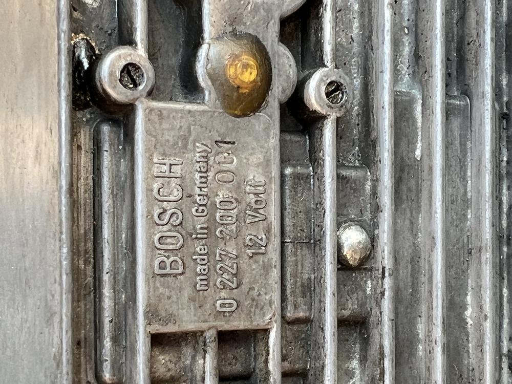

    Could it be my 3-pin BHKZ (below) that wouldn't work with my config ?
    THANKS !
