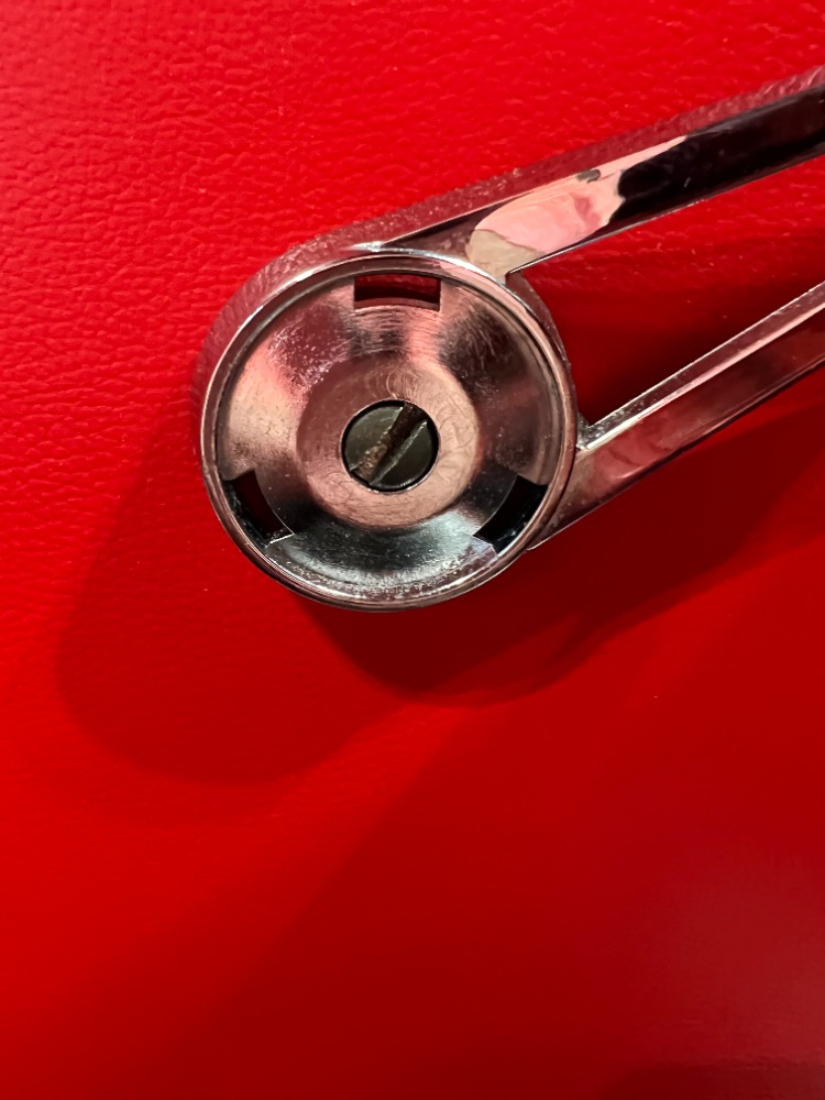

    Senior Member Dezzmo's Avatar
    Nov 2006
    Rhode Island
    471
    Here's a pic of the handle (OEM) with the plastic cover removed.

    Mar 2023
    Rockies
    119
    Tim, it looks like you have a 356 door opening handle on this 911 door. Of course you have a 911 window crank too. Given the 911 door opening lever pulls and does not appear to rotate, how does the 356 handle perform that function? I havent disassembled my door yet. Im just lining up my ducks first.
