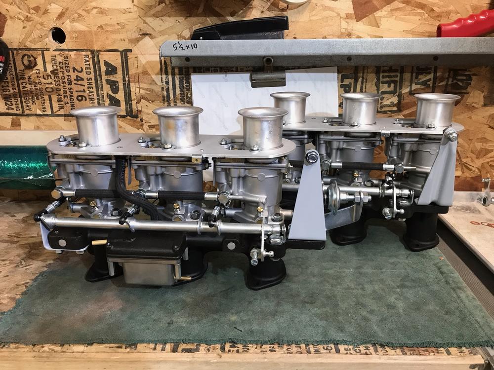

    See attached tech manual and photo of my last project, completed two weeks ago. If you have Solex issues then I can help, I've serviced 29 sets, including yours.
