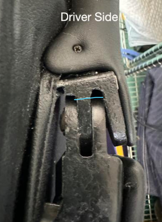

    The fingers in hinge connection between the side frame rail (driver’s side) and those of the front folding rail are splayed out as shown in the pic below. This causes the front not to seal well on the driver’s side. Is it possible to bend these fingers back together or will that likely break them? Does anyone have a left targa top side rail for a G model? There is one on eBay but it specifies for F model. Is there a difference between rail for F and G?
    This is for a 73 911.
    Jim

    Is that little blue line a crack?
    Seems so to me

    Yes it is but goes only a fraction of the way across. Don’t know status of the back.

    Would appreciate any advice about repairing this or sources for replacements? Also are the parts different for G vs F models?

    Tony at Autobahn restored the top. It also has a new front seal from Targa Dan. Now I see that driver's-side frame arm needs to be replaced because the hinge finders are spread and one looks like it is cracked. I'm having trouble finding one.
