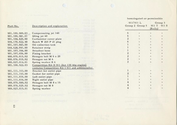

    For the hold downs on the catch tank, i've used two metal tabs that I found in later 911's (1971 parts book shows # 901.503.075.00) they are used in the trunk to hold the the side fender trunk mats in place, look at the fender bolts, and you'll see 6 per car, just remove the snap and you end up with a flat metal braket, one end has a 6mm hole and the other has an 8mm, just bend it 90 deg. The rubber strap is part # 644.628.091.00, the hexagon bolt size is M 6 X 20, the washer is a spring type B 6, and the nut is a plain M 6. I have two that I can send you, no charge, just e mail me with a mail address. The photo shows black painted, and cad plated ones. No one will ever know. I have reference info for early 911's and the Typ. 911R

    Sportskit part #
    hope this works, e
