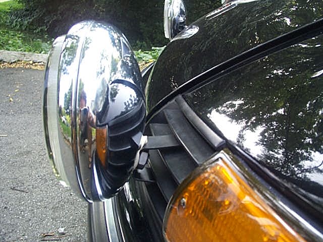

    Well, I finally got around to mounting the NOS vintage Bosche lamps taht I bought a few months ago. They are slightly larger than the Hella's, but much cheaper
    Im still not used to the look of them. Its funny how you can love a modification on everyone elses car, but be unsure of it when you do it to your own car. I think its going to take some time to get used to.
    I made my own brackets to mount them on because the mounting is different from the hella lamps and I didnt want to cut the horn grills. I used 1" wide stainless strap material to make them from. Pleanty sturdy and totally reversable. Opinions????

    Here is the mounting.

    Dave, I think they look great! -- Curt
    Very nice
    That is how the factory should have done it. I never understood the need to cut the horn grills, you have proven that it can be done without the butcher method.
    Looks great, now I want to do it. Shawn.

    Dave..no need to feel any guilt trips. They look fine, if you want thru the grille lights. Now it's my "confession" time...I like the early 911 lines better without added lamps. A personal taste thing, for sure. But even back in '74, when I bought my car, I was sort of turned off by the through the grille factory fogs. Probably because I liked the lower bumper mounted fogs of earlier models...not sure why, to tell the truth. But, since I liked the rest of the car, I bought the car despite the lights. I kept them on, because the factory put them there. Is it just me, or is it only lately that the through the grille lights have become "hot"?

    Looks Great! I like the simple and clean mount.
    Where's the wire?

    Good eyes Jared. No wire yet because I havent found a source for the old Bosche bulbs. They are approx 1" dia bases and I cant seem to find a supplier. Any suggestions?

    That is a much better mount than factory (gasp go the purists). Excellent job, very clean, and no hacking required. You should market them.
