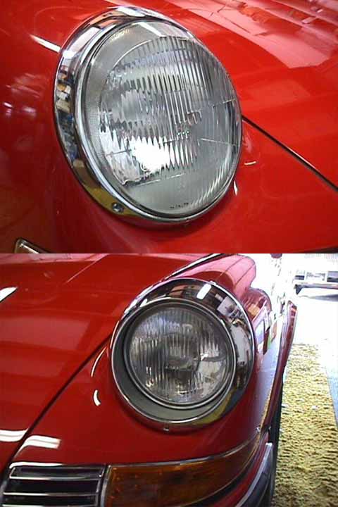

    I am having H4's put on my car. Mike told me that I have the choice of original chrome rings, Euro rings, "no rings". I kind of like the original look of the large chrome rings.
    Do you guys have pictures of my options, and suggestions? The car also came with chrome wheel well accents. But it seems that no one is using them. Were they an unusual option, or do you guys just like the "pure" look of the uncluttered chrome-free car?

    Chrome. The early cars look better with an accent around the headlight. I'm guessing the "Euro" look means you get your rings painted to match the body color. This was ok for later cars but on, let's say, anything built before 1978 the chrome looks appropriate.
    Best of all you don't have to take the things apart to get the rings painted and then put them back together. Not difficult but why bother?
    H-4's in chrome; plug and play.

    On a silver car, definitely chrome. Your real choice is the big US surrounds or the Euro one.
    Most guys choose the Euro one, since it's how the car was originaly designed, and -- to most eyes -- looks a lot better.
    Here are some links to give some perspective:
    One
    Two
    Three
    Four
    Five

    Thanks for the info and the pictures. I also spoke to Eric Linden today, and got the scoop. I could do H4 bulbs inside the Large US chrome rings, or do H4 assemblies and lenses with the smaller chrome rings that go with the Euro setup.
    The Euro setup sure looks lots cleaner. And now I understand the alternatives.
