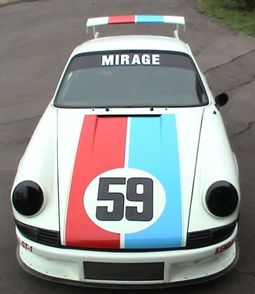

    I'm looking for some general advice for upgrades on a '68 911 RSR that my son and I bought a couple of weeks ago(couldn't pass up on the price-under $4000).
    Our plans are for street use and some local Porsche club/SCCA events. And of course we are operating on a limited budget as far as $$$ spending is involved.
    1. Should we keep the 2.0 original motor and rebuild and upgrade?
    2. We have the original Sportomatic in it, but have an early 5-speed 901 that came with it. We're thinking converting to the 901 for better performance?
    3. If we do upgrade to a stronger motor, ie. 2.7 or 3.0 will the 901 transmission hold up without problems or should we move to a 915?

    I have to confess that I'm more of an anal-retentive restoration/preservation enthusiast than an R-Gruppenfuhrer. Have you considered looking into what it would cost to get the RSR kit off? That probably would be the move that would add the most value to your car.
    The FIRST thing you need to do before making "upgrades" for PCA or SCCA competition is look at the rules and learn and understand what you can and can't do in any specific class.
    If you put in a bigger engine, you'll probably go up in classes, and need a bunch of other modifications to stay remotely competitive. If you stay at 2.0 a more stock '68 could do better--assuming the RSR kit doesn't push you out.
    You might also want to think about the benefits and risks of adding lots of engine to a short wheelbase car, unless the RSR kit changed your wheelbase.
    It pains me to admit it, but dropping in a good used engine is probably cheaper than rebuilding an existing engine.
    As far as the 901 transmission goes, a recent Bruce Anderson column recommended Otto's in Venice CA as a source for beefing up the 901.
    By the way, what model did your car start life as: In 1968 there was the US-only 911L, the rest-of-world 911S and the 911T (sold in the US as the 911)? Come to think of it, there was also a rest-of-world 911 which was more like the US-only 911L.

    If the car you bought is stock? or can be changed back easily? then by all means keep the orginal motor. I definately would keep the motor even if it is on the garage floor, and you went to more potent powerplants.
    Put the 901 trans in...Sportos have a tendency to break and are troublesome at best. It's that dam electric switch on the shift stick.
    I think on a budget I would rebuild what you have, keep your mods within reason. Accept the fact that the 68 Chasis and motor has limitations.
    Otherwise it's a slippery slope... by going to the 2.7 etc and purchasing a 915, your more than likely going to want to screw around with the suspension and brrakes sooner or later...one thing leads to another...which all cost mucho $$$$. Porsches are not cheap cars to mess around with.. Go price a rear tail light lens for a 68 and you will get my meaning.

    Dan, I would proceed with the tranny change out. If, when finished with that project, you still have a taste for more, there will be plenty of things to choose from.
    For the trans changeover you will need a pressure plate and disc, a pedal cluster with the clutch pedal and new footboard and the shift linkage. The tunnel for the clutch cable is already in the car, but you need a cable. I don't know if the flywheel is the same or not. Also, don't know if the trans mount is the same or not.
    But you get the idea. You can find a lot of these parts at Pomona for not too much money. Plan on rebuilding the pedal cluster. This is not a big or expensive project. But you will be into the master cylinder when changing, so this project can lead to others (as they so often do).
    You will want to examine and regrease the CV joints when you disconnect them. As I said, when you get done with this change out, you will know whether you want to keep working on the car.
    Is your 901 a 5-speed? You will enjoy the car as performance car quite a bit more with the manual trans. One of the guys I hang with has a clean '72 MFI Sporto. When we take his car, it's a great cruiser. He drives like an old woman anyway. When we take my car, he turns white. Big difference between 130 hp in a Sporto to 180 in a 5-speed.

    From emails with the previous owner, I understand the car was upgraded on the front for solo events, ie. stainless lines, torsion bar, etc.
    The RSR upgrade was done professionally and looks very clean so we'll keep it that way, interior is good for original, and has solid Centerlines, 15x8 rear, 14x6 front.
    From the ID #, the car was an early build '67, US car
    Vin# 11830165 engine # is 901/17 10584
    Engine cases #217, heads? stamped K1819 8-67
    Not sure if these numbers identify it as a early 911S or L
    I think the numbers for the cases mean 2.0, 130 hp???
    The CV joints and axles have been replaced recently, but the exhaust is completely gone, and the carbs were ruined when the previous owner decided to rebuild them without any knowledge or help. He handed them to me minus half the pieces.
    Is Motormeister in LA a good place to go for Weber setups? I saw a complete set available for around $2000.

    A 901/17 decodes as a 911L (USA) engine with emission control and Sportomatic.
    I have never dealt with Motormeister, I don't recall hearing anything good about them. I think I recall hearing Excellence refuses to run their advertising.
    A 911L should have come with Webers--why do you need new ones? You can have them overhauled at Eurometrix http://www.eurometrix.ws/ That might run a bit more than Motormeister, but it might be a better approach.

    Two fellows I autocross with have "hot rod" 2.7 L engines with 901 trannies (one in a '66 911 and the other in a 914) . They seem to be holding up ok.
    As far as upgrade to larger displacement or rebuild, a rebuild of any Porsche engine costs about the same. If you buy a used engine, you may be facing a rebuild in a year or two anyway. You pays your money and you takes your chances.
    Unless you have a need to keep the 2.0 for racing classification (or whatever), I would consider replacing it with a sorted out 2.7 L so you get more power and less peaky type performance.
    Good luck however you decide.

    Thanks to all who have replied to my questions. I have learned alot just from reading all the tech stuff and general stuff on the BBS.
    Is there a market for a long block 2.0 (case with P&C's still intact) nothing else? And a Sportomatic transmission?
    I'll get the 901 5-speed rebuilt and look for a 2.7 or a 3.0.
