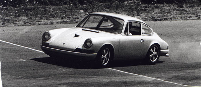

    R's in the back and standard 7's on the front? Errr, wouldn't that look a little weird. Tom, I hate to disagree, but here's a pic I took back in the early 70's...a factory prepped race car known here as "the silver weenie"...I believe the wheels in this pic, taken at an auto-X after the car's race days were over are R wheels...on all 4! If it was done back then on a short wheelbase car, I don't see why it couldn't be done on a later model.

    I second the notion of not using later 7's up front. That would look a lot like an import drag racer where the big tires go up front and the little ones are in the rear. Balance (in this case "the look") would be completely wrong. Get some early deep sixes to compliment the package.

    I agree...deep 6's front, R wheels rear are a good set-up, the way many guys go...but I did want to point out that R's on all four has been done...
