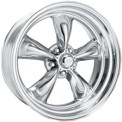

    I spoke with a district representative about these-
    http://www.americanracing.com/wheels...0rim&section=V
    The Torque-Thrust II Classic (series CL205). He called "Central Comand" and said that he had a listing for the 911 and gave me a reasonable price of $265 each. I never followed up on it, so I don't know if this is all reality or not. Although I was pretty psyched about the prospect.
    This is the wheel that Ford used on the new Mustang Bullit.

    I need to ammend that a little. It was the Torq-Thrust II Custom Offset (Series 405). AR's web pages don't show the 911 bolt circle but I was told it was availlable.
    A reality check is called for. You know, due diligence. I never followed up.
    This is the wheel-

    I would be really suprised if they are able to make the offset needed for a non flared 911. The bolt circle is one thing but I belive that with the two piece design of the TTII's that you cannot get the 4 3/4" backspacing needed to fit them on an early car. Probably would work on an SC. I could be wrong tho
    For what it is worth, there is a difference in the Hot-Rod "Americans" and the Sports Racer "Americans". The Hot Rods and most musclecars used the standard straight spoke wheels that had the ridge running the length of the spoke. For the disc brake equiped Corvettes, Shelby Mustangs and Cobra's, American created the D-spoke which has the arched spokes. (similar to pictured above) The Porsche wheels came along a few years later and are easily identified by the goofy positive offset that placed the spokes all the way out toward the face of the rim.
    So, the D-spokes would be a fairly accurate replica of the Aluminum Porsche wheels of the 60's if you were able to get the offset made.
