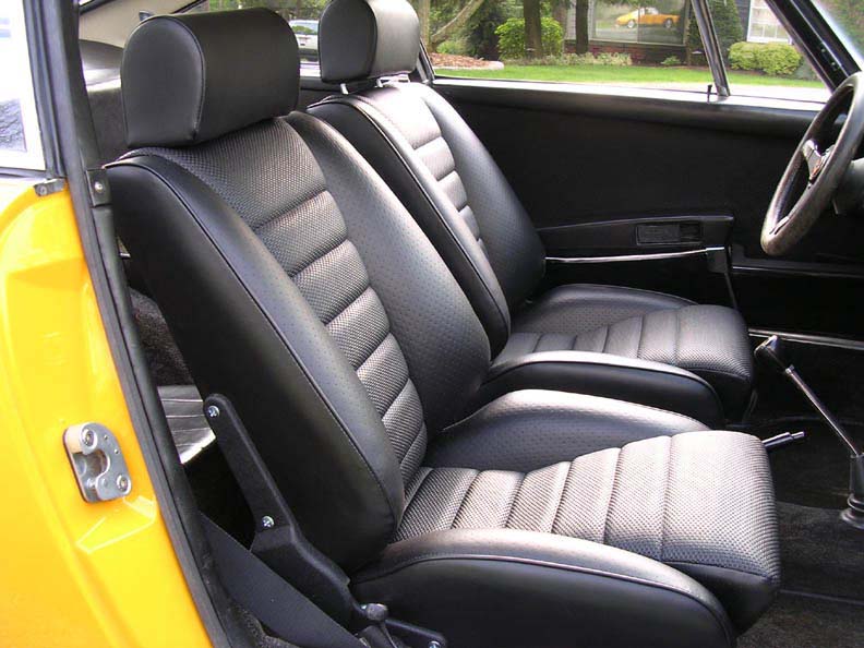

    The seats will be redone in German Vinyl and the repro Houndstooth I'm sourcing. Saw a picture of sports that were redone by Autos, and they were basketweave with perffed vinyl on the bolsters.
    So, with the houndstooth inserts, and a '73 E Targa, should the vinyl on the bolsters be perffed or just plain jane?

    Like these
    06 - Lexus IS250 MT6
    98 - Volvo 70V XC
    Those seats look like "Basketweave" rather than "perforated". I have a pair of 68 sports seats which are mainly original in Basketweave

    Those are '71 seats pictured. '73 had non perf-ed side bolsters in vinyl or learher, perf-ed inserts were an option.
    Jared

    It looks to me that the basketweave inserts and the perorated bolsters on the seats in the signal yellow car are the 2.2 configuration.
    My recollection of the 2.4 sport seat configuration is:
    - Leather or Leatherette
    - Inserts of leather or leatherette (perforated)
    or
    Cloth (hounds tooth weave or corduroy)
    - Bolsters in leather or leatherette smooth (not perforated)
