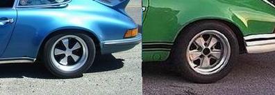

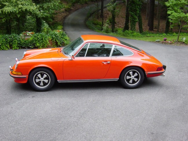

    RS Flares....
    Now you see them....
    Lars Wikblad...
    Early 911 "S" Registry # 527
    "R" Gruppe # 314
    Senior Member larwik's Avatar
    Dec 2003
    Los Angeles, Ca
    1,089
    RS Flares....
    Now you don't........(SC Flares...)...

    12,110
    Great example Lars
    And now they are all gone (never there!)
    Tom

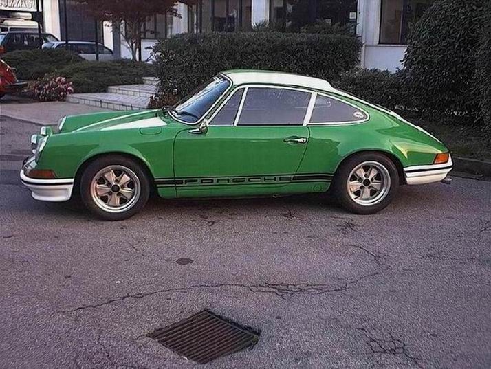

    And sometimes they get completely out of control:
    (I'll concede that Tom's looks better. The unflared look is the purest expression of the original 911 design, in my opinion.)
