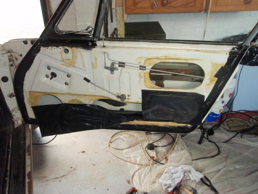

    Here's a coupe of photos of my unrestored largely original 66 Ivory coupe (laid up from 1977). As you can see I did slightly 'overdo' the black strip near the top RH corner. Also originally the inner edge was very rough and it looks like it was hand-painted to a masked outer edge. Colour is what I would describe as 'semi-gloss', or a 50:50 mix of black gloss and satin. That's what I used and it looked ok.
    Mick

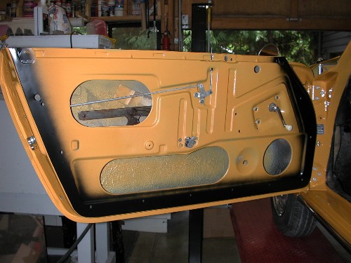

    Bob, below is a reference pic from Darryl Deppe´s 912-restoration. I believe satin black is the correct way to go, Würth´s is a nice match.
    http://www.darrylsgarage.com/912/912.htm
